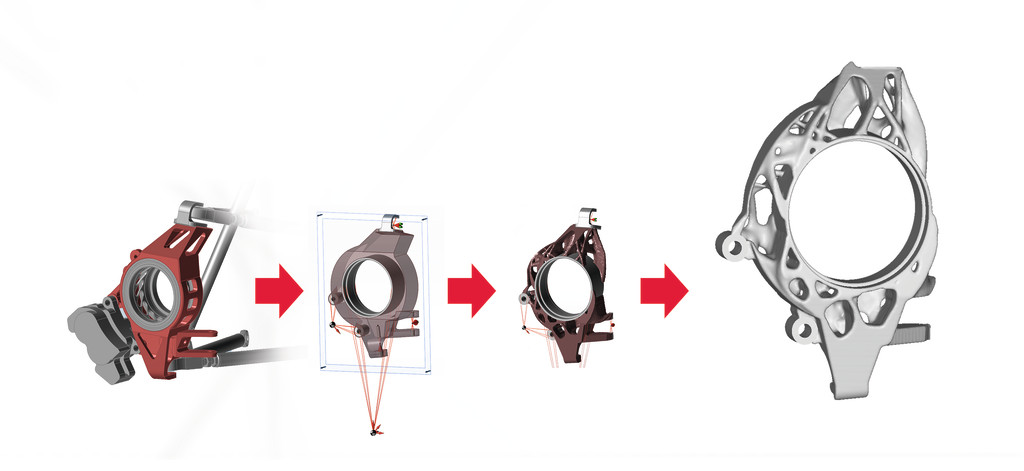

    This one: 440g full blown topology optimization with camber and toe stiffness as design targets, then a 3d-printed mold pattern and then cast from aluminium. Not an actual part for a car, only done for demo purposes of a nice simulation driven product development process ;-)

    One thing I've never seen is someone put a specific value on how stiff they need to be for camber & toe control, with solid reasoning behind it. Especially toe compliance.
    JT A.,
    I posted such numbers with reasoning back in 2005. In the last ~4 years I have linked back to those posts several times, and added more numbers and reasoning. Over the years, many other people have done same. Bill has just added yet another such post. There are even some papers/theses floating around the web, which give good numbers and reasoning on the similar issue of "How torsionally stiff does a FS/FSAE chassis need to be?".
    In all cases, the answer is that below a certain level of stiffness the performance is adversely affected (by a quantifiable amount). Slightly higher levels are "good enough" (quantifiably!). And really high stiffnesses are a tiny bit better again, but cost a great deal more (again, quantifiably...).
    So, are all these numbers and reasoning making any difference?
    Judging by the many design cock-ups I keep seeing, the answer is mostly NO! Why?
    It seems to boil down to the current generation of students' lifetime of indoctrination (since first kindy classes) that:
    "THERE ARE NO RIGHT OR WRONG ANSWERS! Each and every person's opinion is equally valid. And regardless of how catastrophically your uprights fail, you all deserve a gold-star!" <- And the dim-witted hordes believe it!
    I am not exaggerating. It is becoming quite painful seeing and hearing it over and over again...

    Matt,
    Given you have failed in your attempt to post a pic here (I keep getting "Server Not Found"), I am dubious of your FEA optimisery skills. Just ~300 grams???
    Can you try to post some pics again?

    I would be surprised if they were 350g. The toe link extensions look quite delicate too.
